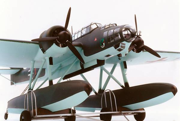

The He-115B model had already been completed once.
After many years, however, the painted surface had deteriorated. Cracks and mold appeared, and the model could no longer remain in its former condition.
Mr. Fukuda therefore undertook a major reform.
He removed the old paint, cut away the nose section, rebuilt parts of the aircraft, remade the canopies, corrected surfaces, engraved panel lines, prepared markings, repainted the model, installed the engines and floats, and finally brought the model to completion once more.

The new nose section was shaped and trial-fitted. Canopy formers were made. Heat-pressed parts were tested. Gaps were corrected. Interior parts were installed. Surfaces were prepared again.
Each step depended on the previous one.
The work was not a straight line from plan to result. It was a sequence of adjustments.
