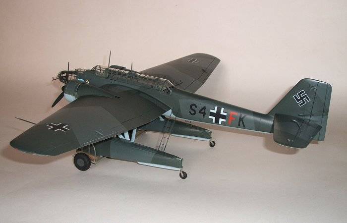

[2008-02-23 12:19:41] No.676
Completion
Completion
Original post text: Kazu Fukuda / English translation
It is finally completed.

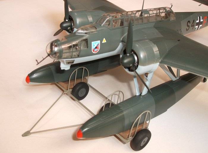

[2008-02-23 12:15:59] No.675
Attaching the floats to the body
The floats were attached to the main body, and the propellers and machine guns were also installed.
With this, the model was finally completed.
It is shown here placed on the float trolley.

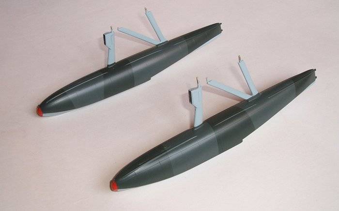

[2008-02-21 16:45:25] No.674
Finishing the floats
Small rings for passing mooring ropes through were attached to the tips of the floats.
Now the only remaining task is to attach the floats to the main body.

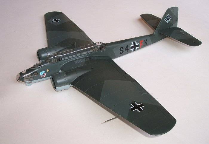

[2008-02-21 16:40:35] No.673
Attaching the horizontal tailplane
The horizontal tailplane was attached, and the engine cowlings were also installed.
Mass balances, the antenna, the pitot tube, and other small parts were also attached, so the model has finally begun to look like a convincing He 115.

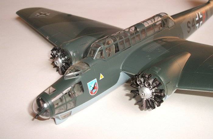

[2008-02-20 16:39:00] No.672
Attaching the canopies and engines
The masking was removed from the bombardier’s canopy, and the canopies for the cockpit and rear gunner’s position were attached.
The BMW 132 engines were also installed in the nacelles.

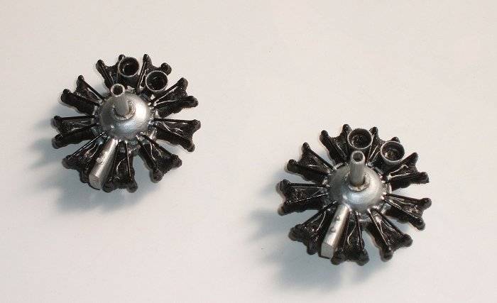

[2008-02-19 15:31:42] No.671
BMW 132 engines
BMW 132 engines
The BMW 132 engines were finished.
The cylinder blocks and crankcases are resin parts that were given to me by the late Honorary Chairman Kotakeuchi. Push rods, ignition plug wires, and other small parts were added to complete the assemblies.

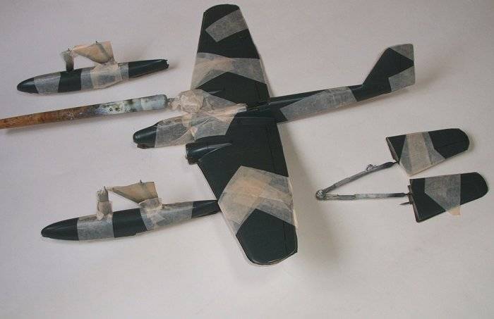

[2008-02-18 13:43:02] No.670
Painting the upper surfaces
After the RLM 72/73 upper surface colors had dried, the masking was removed.
Small scratches made when removing the masking tape will be carefully touched up with a brush.

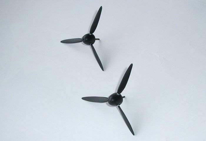

[2008-02-17 13:54:42] No.667
Finishing the propellers
The propellers and spinners were also painted and finished.

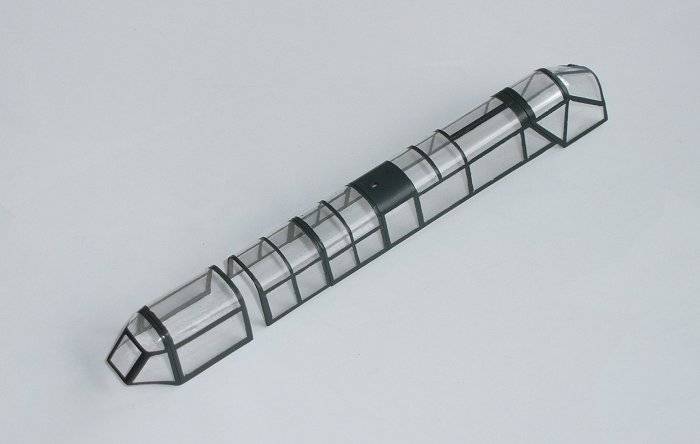

[2008-02-17 13:53:32] No.666
Finishing the canopies
The canopies were finished.

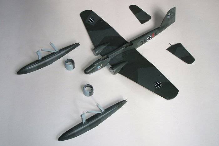

[2008-02-17 09:45:23] No.665
The upper surface colors are the RLM 72/73 splinter camouflage.
RLM 73 was painted first, and this photograph shows the model masked in preparation for painting RLM 72.
