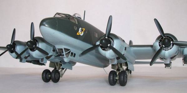

This record preserves the making of a large four-engined solid model aircraft. It follows the work from material preparation and trial assembly to interior work, nacelles, engines, propellers, bombs, painting, final assembly, and completion.

The Fw 200 C-3 record is a parts-based and process-based construction record.
The original material was not arranged strictly in chronological order. It had been organized mainly by parts and fields of work, such as mock-up, nacelles, engines, machine guns, propellers, painting, and completed photographs.
In this archive, the record has been reorganized as far as possible according to:
  • confirmed dates
  • relationships within the original text
  • the state of work visible in the photographs
  • the natural order of model-making procedures
This reconstruction is not intended to replace the original material. It is intended to make the progress of the making process easier to follow.

The original record pages preserve the construction process as source material.
Original 01
Material preparation and the emergence of the overall form
Material cutting, shaping of major blocks, trial assembly, and confirmation of the overall form.
Original 02
Interior, cockpit, canopies, machine guns, and gondola
Interior parts, cockpit, side windows, canopies, machine guns, and gondola work.
Original 03
Nacelles, cowlings, wing attachment, and mock-up completion
Cowlings, nacelle parts, attachment to the wing, tail surfaces, and mock-up completion.
Original 04
Spinners and propellers
Spinner material, shaft-hole work, rotating shafts, propeller blades, painting, and assembly.
Original 05
Engines, bombs, and accessory parts
BMW Bramo engines, SC500 bombs, accessory parts, and the decision to wait for drying before painting.
Original 06
Painting and markings
Surfacer, national markings, unit codes, underside color, upper camouflage colors, and preparation for finishing.
Original 07
Final assembly and completion
Cowlings, engines, machine guns, antennas, propellers, final assembly, and completed model photographs.
