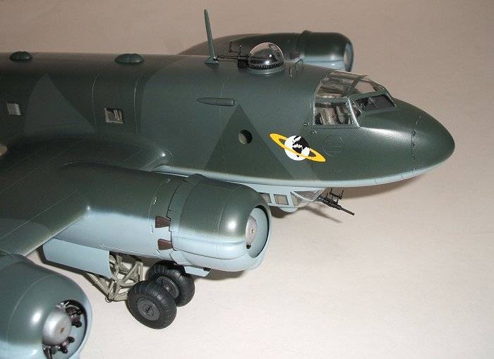

Nose Upper Rotating Turret and Forward Gondola Gun
Nose upper rotating turret and forward gondola gun
Original post text by Kazu Fukuda / English translation
I attached the 13 mm machine gun to the rotating turret on the upper nose, and the 20 mm machine gun to the forward part of the gondola. The gun barrels are made removable.
I also attached the antenna mast, cabin air intake, and cabin ventilation outlet on the upper fuselage.
Here, machine guns are attached to the upper nose rotating turret and to the forward part of the gondola.
The point to note is that the gun barrels were made removable. This can be read as a practical judgment for protecting thin, easily damaged parts during later handling and storage.
The addition of the antenna mast, air intake, and ventilation outlet also increases the amount of visual information on the upper fuselage and gives the aircraft a stronger sense of presence.

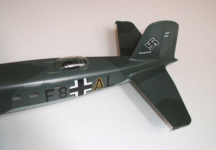

Rear Upper Fuselage Rotating Machine Gun and Sliding Canopy
Rear upper fuselage rotating machine gun and sliding canopy
I attached the 7.9 mm rotating machine gun and sliding canopy on the rear upper fuselage. This canopy resembles the one on the Heinkel He 111.
I painted sortie marks and ship-sinking marks on the vertical tail.
In this entry, the rotating machine gun and sliding canopy on the rear upper fuselage are attached.
Fukuda notes that this canopy resembles the one on the He 111. This is not merely a statement that a part was attached. It shows that he understood the character of the part through comparison with another aircraft.
The sortie marks and ship-sinking marks painted on the vertical tail also strengthen the individuality of the aircraft.
These markings are preserved here as part of the historical and documentary record of scale model making.

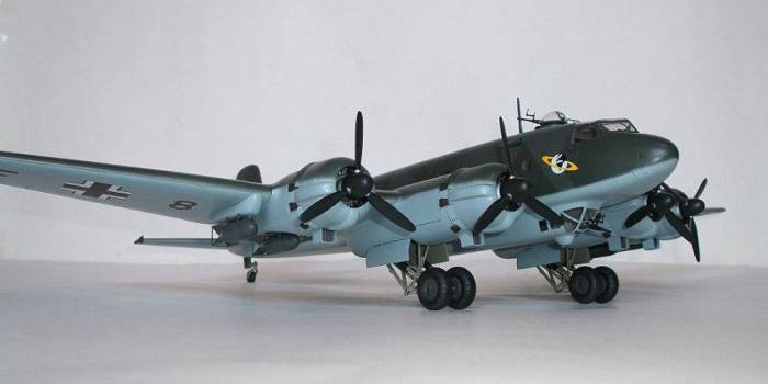

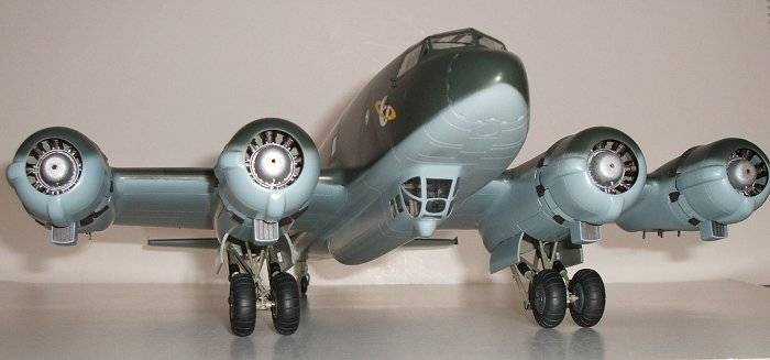

Left Front View
Completed Fw 200 C-3, left front view
The left front view allows the nose, fuselage, wing, four engines, propellers, and the volume of the underside to be seen together.
If an image is needed for the entrance page or for sharing, this kind of oblique front view is one of the clearest candidates.

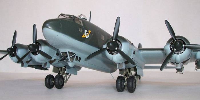

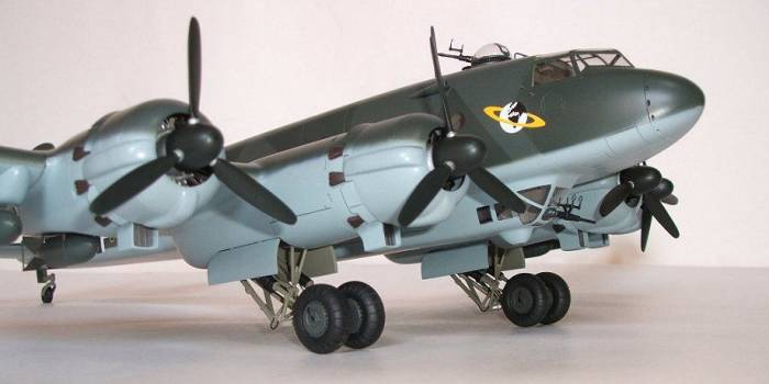

Right Front View
Completed Fw 200 C-3, right front view
The right front view shows the engine arrangement, wing span, and relationship between wing and fuselage from the opposite side.
For understanding the overall form of the large Fw 200 C-3, records from both sides are useful.

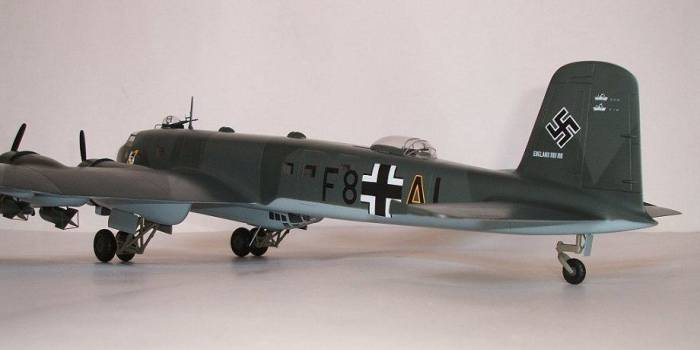

Right Side View
Completed Fw 200 C-3, right side view
The right side view makes it possible to confirm the length of the fuselage, the position of the wing, the tail section, the vertical tail, and the horizontal balance of the entire aircraft.
This angle clearly shows that the Fw 200 C-3 had a long fuselage derived from an airliner.

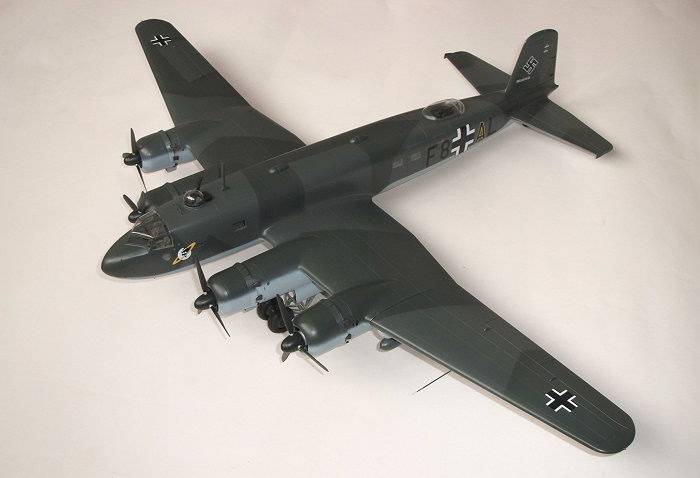

Top View
Completed Fw 200 C-3, top view
The top view makes it possible to examine the wing planform, engine arrangement, tail surfaces, upper camouflage, and national markings.
While the oblique front view conveys three-dimensional volume, this angle is useful for reading the aircraft layout and planform.
