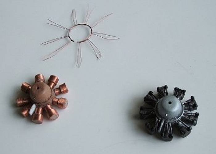

[July 14]
BMW BRAMO-FAFNIR 323 Engine
BMW BRAMO-FAFNIR 323 engine
Original post text by Kazu Fukuda / English translation
The engine is the BMW BRAMO-FAFNIR 323, and the crankcase and gearbox have an unusually large and distinctive shape.
I am making the engine in a classical way. The crankcase and gearbox were shaped by carving artificial wood. For the cylinder blocks, I made round rods from artificial wood and wound fine enamel wire around them.
On the left is the engine at the basic assembly stage. The parts above it are the ignition plug wiring. On the right is the completed engine after painting and after adding small parts such as push rods and plug wiring. I built it up so that it would look convincing.
This entry shows how Fukuda made the BMW BRAMO-FAFNIR 323 engine.
The crankcase, gearbox, and cylinder blocks were made from artificial wood, while fine enamel wire was used to represent the cylinder detail. Rather than fully reproducing the actual mechanical structure, this was work aimed at creating the density necessary for the part to read as an engine at model scale.
Fukuda’s expression that he made it “look convincing” should not be read simply as omission. It indicates a judgment about what needs to be shown in a scale model.

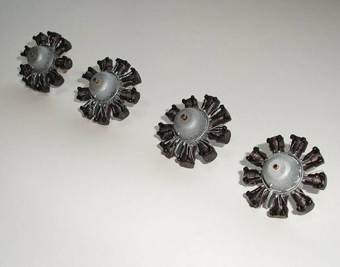

[July 19]
Four BMW BRAMO Engines Completed
Four BMW BRAMO engines completed
The four BMW BRAMO engines have been completed.
After adding push rods, cylinder heads, plug wiring, and other details, I painted them in silver, black, and burnt iron colors so that they would look convincing.
Because the Fw 200 C-3 is a four-engined aircraft, the engines support the overall impression only when all four are present.
Here, push rods, cylinder heads, plug wiring, and other parts have been added, and silver, black, and burnt iron colors give the engines a mechanical appearance.
Making four matching engines involves a difficulty different from making a single part. If the shapes and density do not match, the sense of unity as a four-engined aircraft becomes weaker in the completed model.

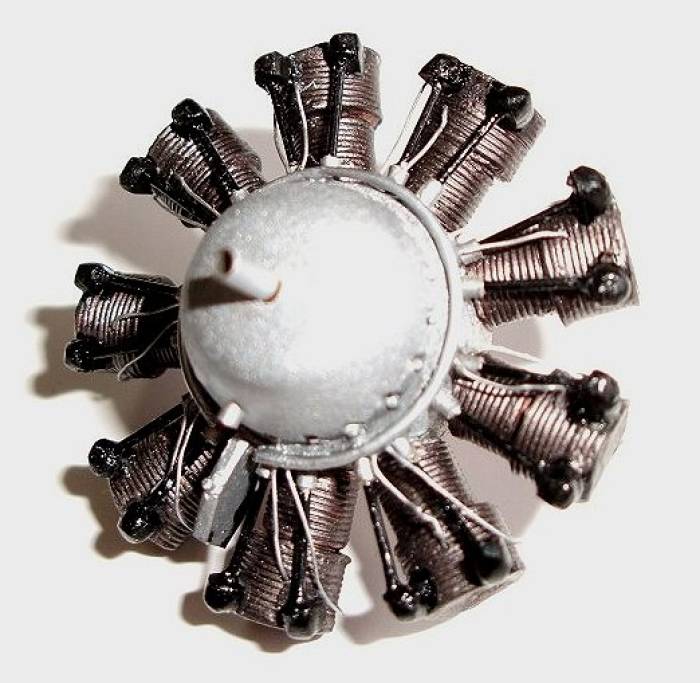

[July 20]
Detailed Work on the BMW BRAMO-FAFNIR 323
Detailed work on the BMW BRAMO-FAFNIR 323
The four BMW BRAMO-FAFNIR 323 engines have been completed. The main parts were shaped from artificial wood.
For the cylinder blocks, 0.3 mm enamel wire was wound around the surface. The bolts at the joint between the crankcase and gearbox are made from 0.5 mm brass wire. For the ignition plug wiring, 0.8 mm brass wire was bent into a ring, and eighteen 0.1 mm enamel wires were soldered to it. The push rods were made using 0.5 mm brass wire and matching pipe.
After painting them in silver, burnt iron, and black, they somehow became presentable.
This entry explains the detailed work on the engines more specifically than the records of July 14 and July 19.
Artificial wood, brass wire, enamel wire, and pipe were combined to represent cylinders, bolts, ignition plug wiring, push rods, and other elements.
What is important here is not that every part was reproduced exactly as on the actual engine. Rather, Fukuda judged which elements needed to be included in order for the engine to be visually convincing within the limits of scale and material.
His modest phrase that the engines “somehow became presentable” reveals an experienced judgment about how to make the part read correctly to the eye.

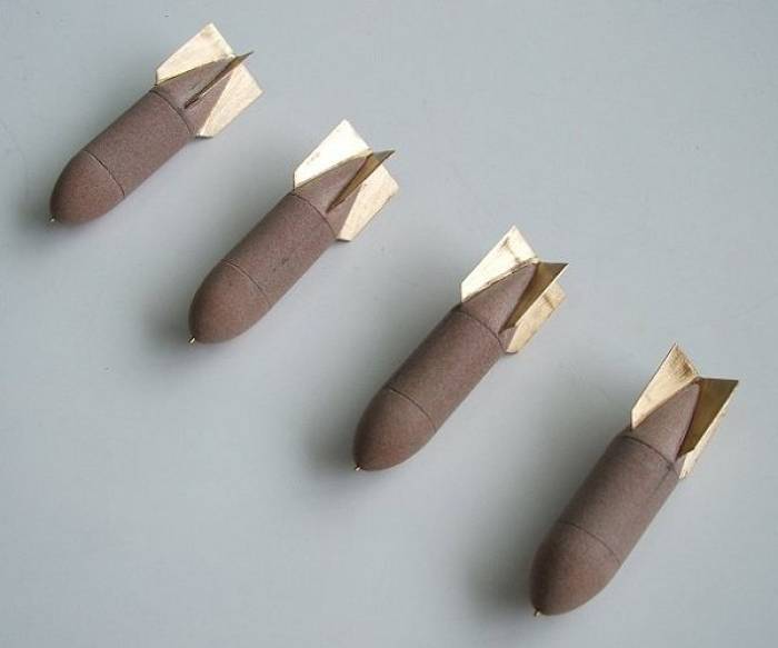

[July 22]
Construction of the SC 500 Bombs
Construction of the SC 500 bombs
I made four SC 500 bombs to be suspended under the No. 1 and No. 4 engine nacelles and on the bomb racks outside them.
The bomb bodies were made from artificial wood and shaped in the same manner as the spinners. The rear fins are made from brass plate. The braces connecting the fins will be made from thin strips of plastic sheet and attached with instant adhesive after surfacer painting and sanding.
With this, all the accessory parts have been completed. The next step will be surfacer painting of the main body, but if painting is done in a hurry, there is a risk that shrinkage or cracking may appear later in the putty-shaped areas. To prevent this, I will leave the model for a while and allow the putty to dry thoroughly. This is planned until the end of August.
I will now begin finishing the Fi 156, which has been left untouched since the end of last year because of the Fw 200 construction.
This entry records the construction of four SC 500 bombs.
The bombs suspended under the No. 1 and No. 4 engine nacelles and on the outer bomb racks are important parts for presenting the Fw 200 C-3 as a patrol bomber.
A particularly important point in this record is Fukuda’s decision not to proceed immediately to surfacer painting after the accessory parts were finished.
He notes that he will allow enough drying time in order to prevent shrinkage or cracking in the putty-shaped areas. This should not be understood as a mere interruption of work. It is an active judgment made to protect the surface condition of the completed model.

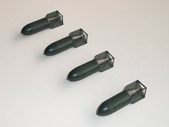

[Date Unconfirmed]
Fin Braces and Painting of the SC 500 Bombs
Fin braces and painting of the SC 500 bombs
I attached braces to the rear fins of the SC 500 bombs that had been made earlier, and painted them.
The date of this entry has not been confirmed, but it can be positioned as the finishing record corresponding to the fin braces and painting mentioned in the July 22 entry.
The bombs are small parts, but once attached under the nacelles and to the racks, they greatly change the impression of the underside of the aircraft.
Therefore, this finishing process is not merely the completion of accessory parts. It can be read as a process that shows the role and character of the Fw 200 C-3 as a patrol bomber within the model itself.
