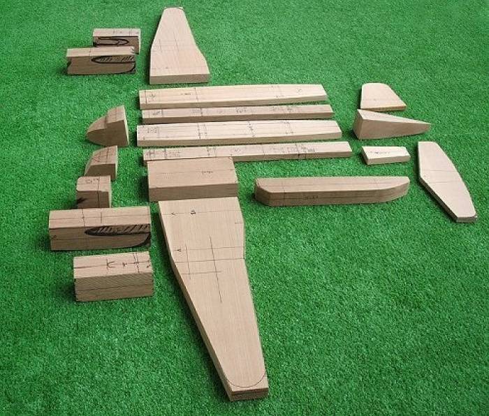

[January 17]
Material Preparation Completed
Material preparation completed
Original article text by Kazu Fukuda / English translation
Material preparation was completed on January 17.
As far as can be confirmed, this record belongs to the earliest stage of the Fw 200 C-3 construction record.
What is shown here is still material before it has been assembled into the form of an aircraft. However, in solid model making, material preparation is not merely a preliminary task.
At this stage, the maker must already anticipate the size, thickness, and carving allowance of the main parts that will later make up the aircraft: fuselage, wings, tail surfaces, nacelles, and other components.
In this sense, material preparation is the work of beginning to place the completed image inside the material.

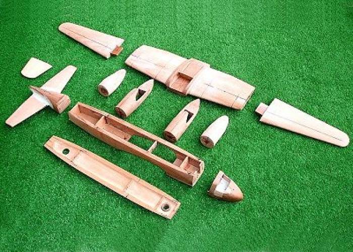

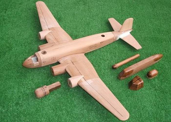

[March 9]
Shaping of Main Blocks Completed and Trial Assembly
Main blocks completed and trial assembly
On March 9, the shaping of each block was completed. I temporarily assembled the parts in order to grasp the overall impression. They are not glued.
The objects in the left foreground are wooden formers for heat-pressing the engine nacelles. The objects in the right foreground are wooden formers for heat-pressing the cockpit, gondola, and gun position canopies.
At this stage, the parts have not yet been glued together.
Therefore, this trial assembly is not a nearly completed state. It is a temporary arrangement for confirming the overall placement, mass, and balance.
What deserves particular attention is that not only the main body of the aircraft, but also the wooden formers for the engine nacelles and canopies are shown at the same time.
This indicates that the large exterior parts and the preparations for later transparent parts and details were progressing in parallel.
Here, the overall form of the Fw 200 C-3 is not yet fixed. It is being gradually confirmed through parts, wooden formers, and trial assembly.
