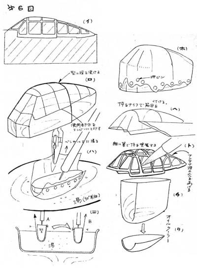

Let us move to the canopy. When plastic sheet is hard to obtain, readily available vinyl sheet is a workable substitute. Note, however, that ordinary adhesives do not bond vinyl well; use an adhesive formulated for vinyl. Also, lacquer paint on vinyl frames can rub off more easily. That said, unless you intend the canopy to open and close, it will not be handled much; vinyl is generally suitable when plastic is unavailable.
See Figure 6. First carve a male mold from wood, as you did for the fuselage, beginning from the side profile. Pay close attention to the angle and width of the forward screen. As in (A), file a step in the mold where the sliding hood would sit; these steps reproduce faithfully in the pressed piece, so even multi-step canopies like those of the Tenzan or Saiun can be replicated by shaping the male mold accordingly. In (B), the forming process is shown “in real time,” so to speak. The critical caution is do not let the water boil. If vinyl is dipped in boiling water, it turns cloudy like frosted glass. Instead, once the water boils, remove it from the heat and use it as the temperature drops. As you stretch the vinyl sheet with pliers, the area under tension will elongate. Pin that point with a thumbtack, then continue drawing the sheet over the mold, tacking down any wrinkles. Repeat on the opposite side. When the usable area is entirely wrinkle-free, stop and remove the part. How did yours turn out? Even without a female mold, this method can yield a clean canopy. Whoever devised it deserves a solid-modeler’s Nobel Prize—if such a thing existed! Next, in (C), lightly scribe the canopy frame lines with a craft-knife tip. Compared with freehand painting, scribing improves precision; the shallow grooves act as paint dams (see D), reducing bleed and making intricate frames easier to paint. Do not forget to cut a small hole for the antenna mast. Finally, (E) illustrates the oil cooler. Rather than carving it from wood, press-forming it in vinyl by the same method is easier; the hollow result, though small, looks more convincing.

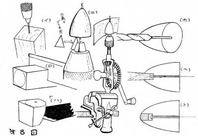

Propeller Construction
As shown in Figure 8, begin with the spinner. Drill into a clean-grained wood block with a bit just large enough for a sewing pin (about 0.8–0.9 mm). Then, as in (B), cut the block 3–4 mm longer than final size. In (C), carve the spinner toward the center hole. If you lack a hand drill, insert a pin and rotate the piece by hand while sanding; it will produce a sufficiently accurate spinner for practical use. If you do have a hand drill, follow (D): mount the same bit in the chuck, cut a small triangular piece of tinplate, and wedge it into the chuck gap. Press the tip of the triangle against the back of the spinner; this lets the spinner rotate freely without the drill slipping. This method yields a well-centered spinner comparable to a lathe-turned part. In (E), drill a hole just large enough for the pinhead. In (F), glue a small wooden plug into the rear, let it dry, and file it flush. Once finished, the spinner should rotate smoothly. Some say that rubbing a little pencil graphite into the pinhead seat improves rotation—feel free to try it
