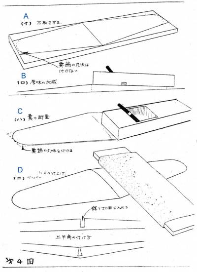

Wing Construction
Figure 4 illustrates the wing procedure. If your stock allows, it is easier to carve the left and right wings from a single board. Choose hinoki free of knots with straight, even grain. In step (A), transfer the template to the wood. For ease of planing, do not round the tips yet. In (B), set the tip shapes and the wing-root thickness. In (C), carve the airfoil section—study the profile carefully before rough shaping. After that, round the tips. Note that the shape varies with distance from the fuselage; this step rewards close attention. In (D), finish the surface with fine-grit sandpaper. Take care not to over-thin the trailing edge and watch for any twist. To form the dihedral, you can either saw a relief cut as shown or simply separate the left and right wings. A note on commercial solid-model kits: some provide wings with the wing-root fillets carved integrally. This removes the need to add separate fillets later, but it makes planing difficult—often a challenge for beginners. As seen in Figure 5, the alternative approach described here offers a cleaner path.

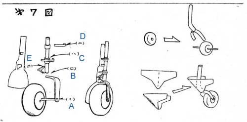

Landing Gear Construction
Now comes the notoriously troublesome part—the landing gear. Unless one is a master carver like Hidari Jingorō, it is virtually impossible to carve such complex parts from a single piece of wood. As a result, metal components—and the challenges of soldering—become essential.
Hidari Jingorō — a legendary Edo-period sculptor-carpenter famed for works such as the “Sleeping Cat” at Nikkō Tōshō-gū; the comparison underscores how exceptional such carving would have to be.
Model railroaders may have some soldering experience, but this work is far more delicate: parts so small you can barely hold them. Still, soldering is indispensable in solid-model construction and worth developing through practice. A soldering iron of around 80 W is suitable. There is no substitute for hands-on learning. If solder beads up and refuses to wet the joint, your iron may be too hot—watch your temperature. Prepare several sizes of plated knitting needles for struts. Use brass sheet for gear doors and tinplate for smaller fittings. For wheels, use 12 mm diameter at 1:50 and 16 mm at 1:30. Assemble in the sequence (A) → (B) → (C), and so on. Thoroughly file the mating surfaces, apply only a very small amount of flux/paste, and solder quickly (it rarely goes perfectly the first time). For the tailwheel, small sizes are not readily available commercially, so you will need to scratch-build them—take your time.
