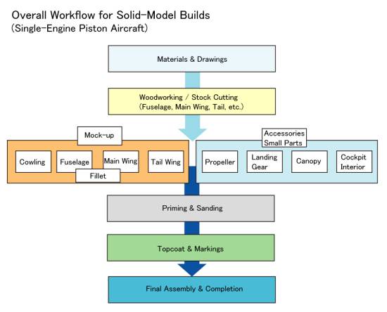

Solid-Model Build Process
When building a solid model for the first time, it can be unclear where to start or what sequence to follow, but the workflow shown in this diagram is generally accepted. Beyond this, you will also need a variety of tools, and you should decide on a dedicated workspace.
