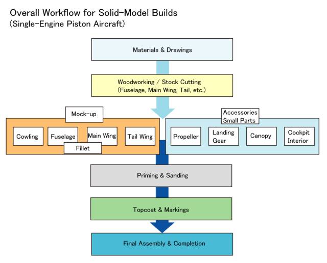

When building a solid model for the first time, it can be unclear where to start or what sequence to follow, but the workflow shown in this diagram is generally accepted. Beyond this, you will also need a variety of tools, and you should decide on a dedicated workspace.
In this series, we will describe the method of solid-model building with reference to the late Mr. Kazu Fukuda’s build notes. For the enjoyable task of aircraft selection, we will proceed with the Fw 190 D-9. Let’s look for reference books at online bookstores.
Prepare drawings as well. Here we will use 1/50, the standard scale for solid models. Because we will create cutting patterns (templates) from the drawings, make several photocopies.
Figure 1-1 Overall Workflow
